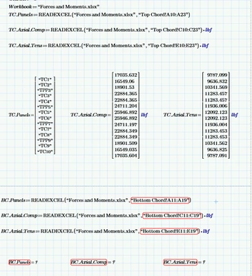

Reading from an Excel File from the second tab in the Excel sheet, MP10
I have attached the Excel and P10 sheet. I'd like to read data from the second tab of the Excel sheet. The P10 sheet can read from the first tab of the sheet, but not the second tab. I don't know why.  Also, I am interested in reading the values in several columns. Is it better to do one column at time, or there are other options? Stuart and Werner helped me with a similar question on 8/29/20225.

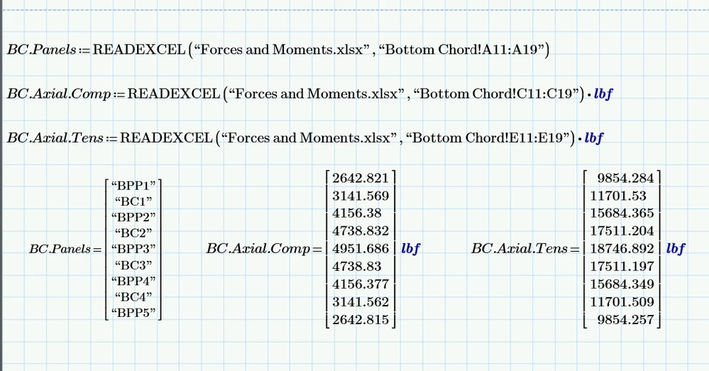

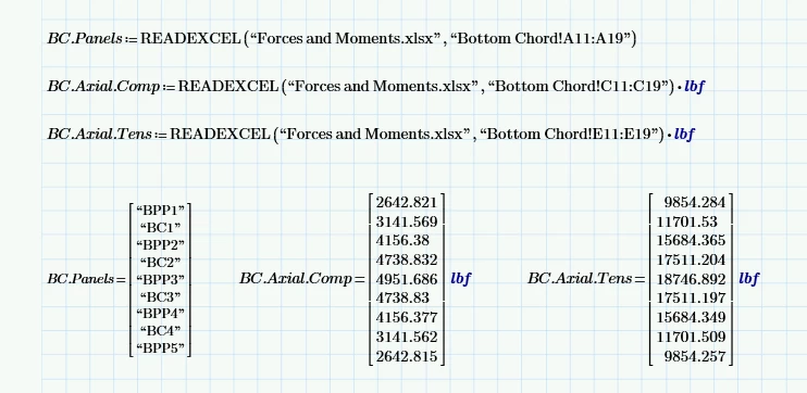

(All I did was recalculate the Mathcad worksheet)
Stuart
