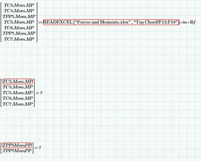

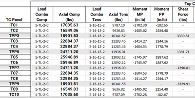

I am reading values from an Excel sheet. I was building on the answer that Werner had for one of the questions. I have attached both P10 sheet and the excel sheet i am reading from. I was able to read the values for some but not others. The problem is there are dashes at TPP3,TPP5,...

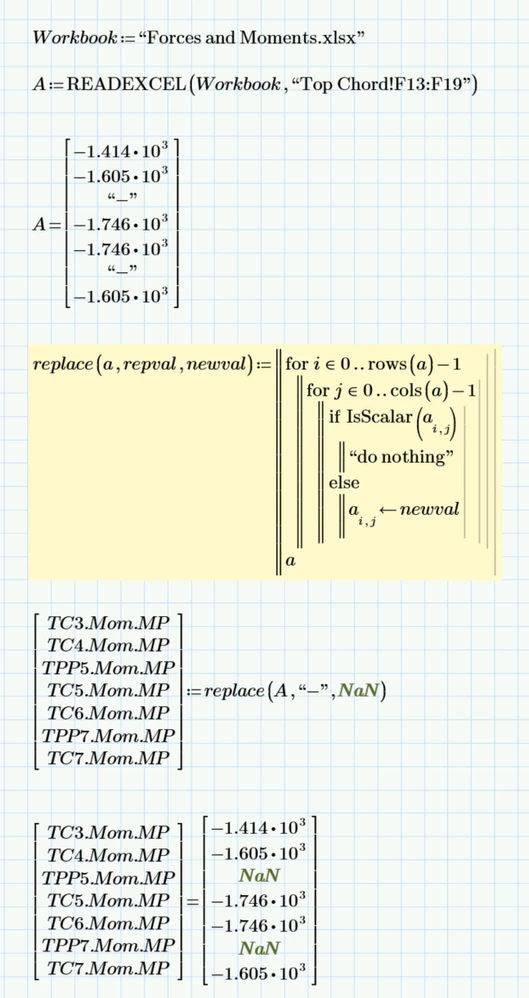

For example, you could do something like the following, Sam.

The reason you are getting the error is that you are multiplying the dashes by a unit (in.lbf), and Mathcad raises an error when multiplying a scalar by a string..
How do you want to handle the dashes within the rest of your worksheet?  Eg, convert them to zero or NaN.

Is it possible to read the excel sheet by skipping the row with dashes
by specifying certain cells like F13:F14, F16:17,.. that corresponds to:
