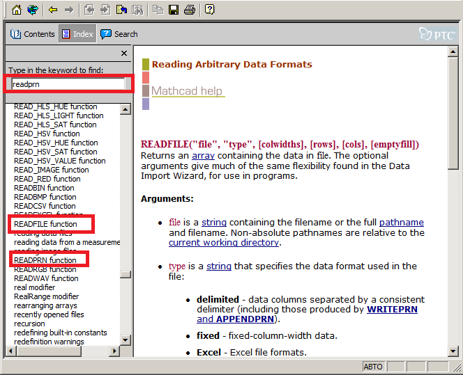

You can use the following built-in functions:
  • READPRN("file") - returns an array containing the contents of the ASCII file;
  • READFILE("file", "type", [colwidths], [rows], [cols], [emptyfill]) - returns an array containing the data in file.
You can find more information about the work of these functions in the "Mathcad Help" file (key F1😞
