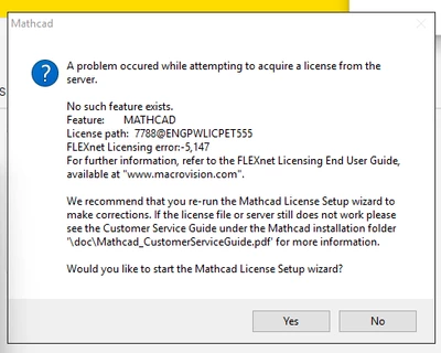

thats the problem (licensing dramas our university is having when opening up mathcad 14.
IS that something that can be fixed? I think it will just be very beneficial for everyone if i continue to use MC14.
So sorry about the massive email chain.
My university won't resolve/can't resolve the issue.
Thanks so much for all of your help so far mate.
Josh
Oct 24, 2023 7:23 AM UTC
It looks like you university ran a license server where you Mathcad 14 connected and retrieved its license. For some reason this server seems not to be up and running anymore. You will have to contact the IT people from your university to ask why.
Maybe the license was time limited and expired and your university can only provide a license server for Prime anymore. I can't tell.
