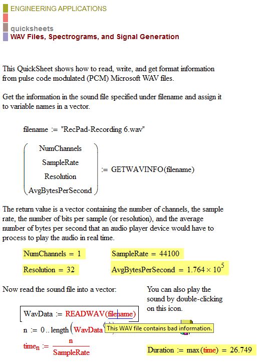

I am experiencing for the first time with WAV-Files reading and postprocessing in MathCAD (15.0). I am using as base for myy first tests the Quicksheet: "WAV Files, Spectrograms, and Signal Generation", only the file reading and spectrum plotting part of it.
I just want to ask if I am right in the assuption, that only 8 and 16 bit resolutions are supported. Because when I try to read a 32 bit WAV file, perfectly playable and correctly interpreted by GETWAVINFO, I get an errror message "this file contains bad information".
