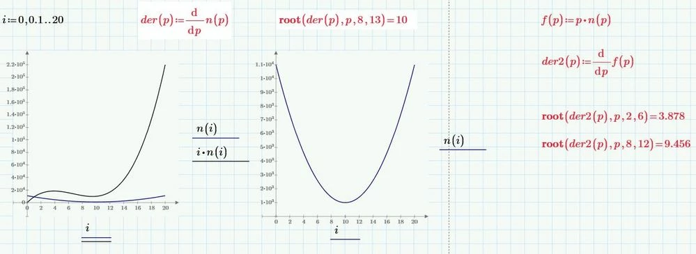

I took a different path using the root function.

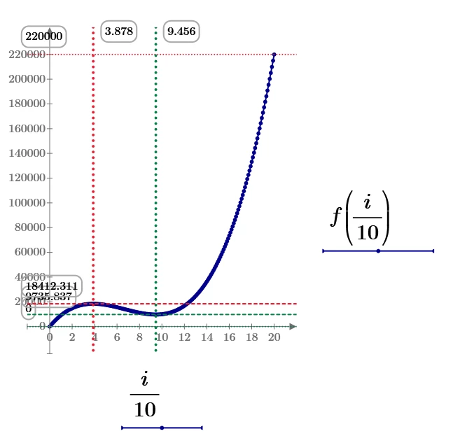

August 27, 2021
