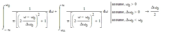

Thanks, Valery.
Prime with new symbol engine
You could also do it this way:
Alan

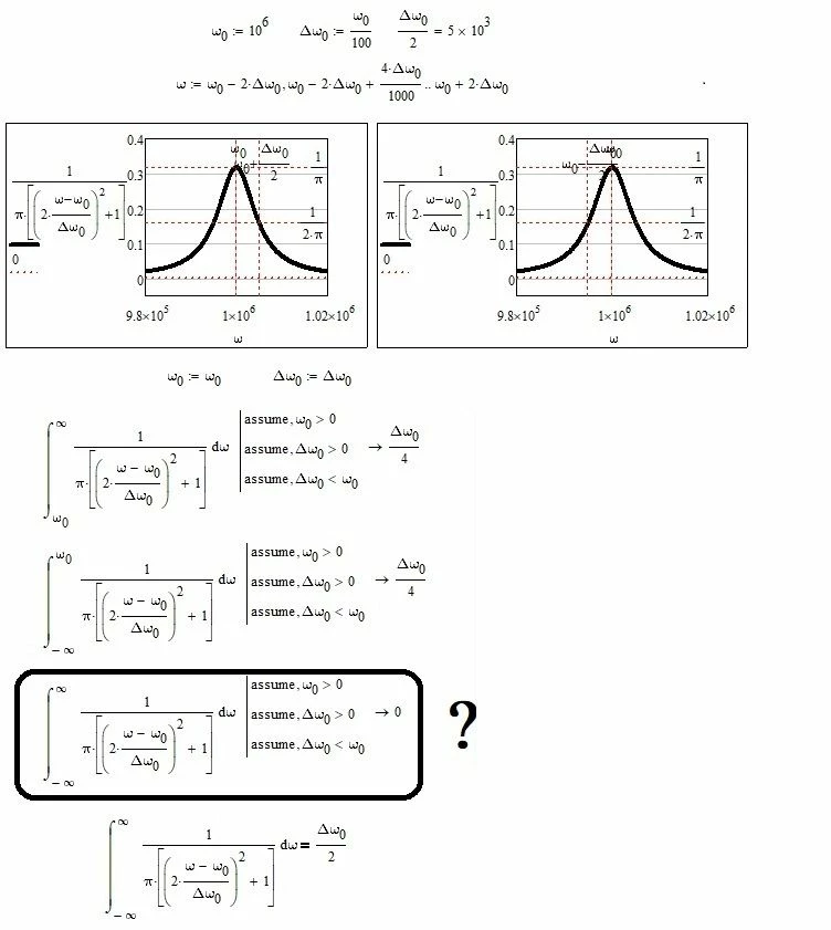

If I remember correctly, we have seen this kind of bug already a few times here in this forum.
Usual workaround is splitting the integral, as Valery had shown.
Here is another (clumsy) workaround (which sure is not satisfying either):

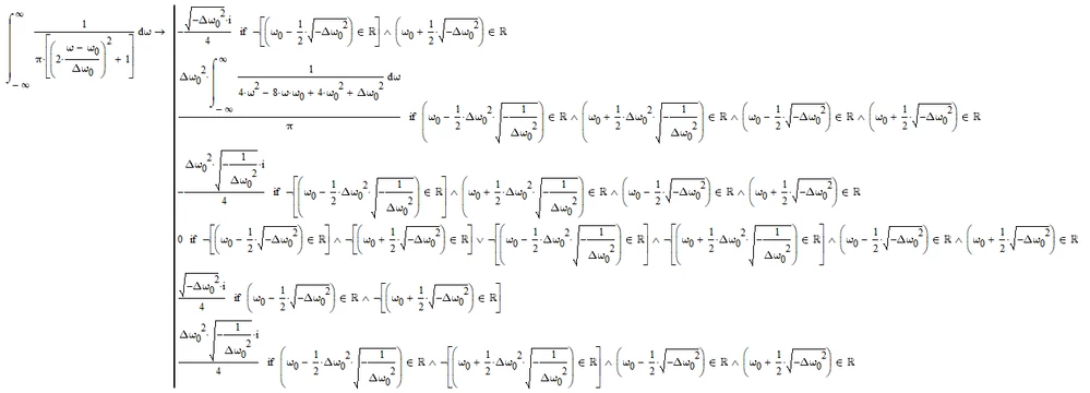

BTW, this is one of a few rare examples where the new symbolic in Prime does better:
EDIT: Had not refreshed the screen for a while and did not notice that Valery also posted the new Prime symbolic.
