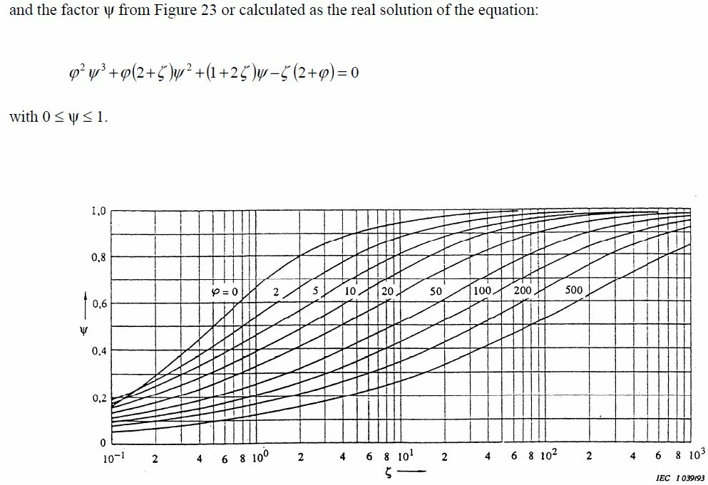

I want to know the solution of the given below equation using Mathcad Prime 3.1.
In above equation, two variable i.e. Phi. & Zeta is given but need to find out Psi.
There is a figure given for reference which tells the relation in these variable as attache herein post.
Can anyone tell me how to calculate Psi using the given references and also if I need to plot it, then how can it be achived.

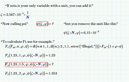

I fired up another machine that has Prime 3.1...
You should be able to continue from here.
Prime 3.1 file attached.

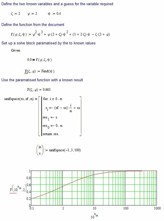

terryhendicott
Enclosed is Mathcad 15.  You will need to convert it to Prime 3.1
Cheers
Terry
