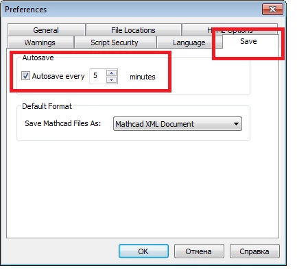

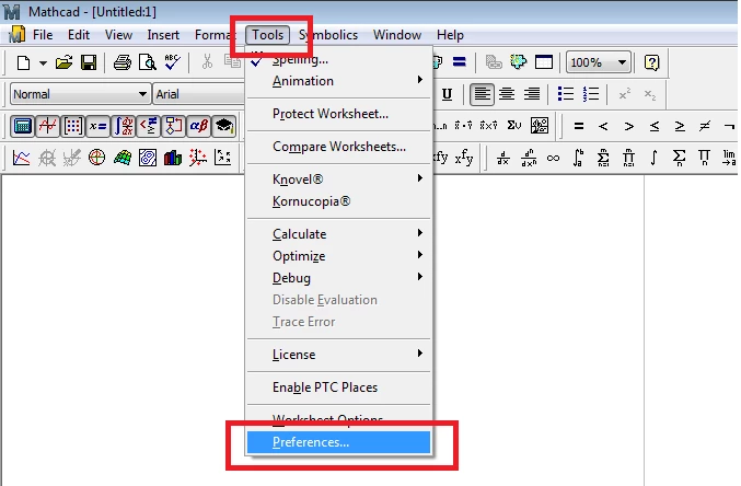

Your file normally opens in Mathcad 15 M040 version. I resaved your worksheet repeatedly and attached to the message, so plese check it. For the future - use the "Autosave" option for your working document (in main menu select "Tools" --> "Preferences" --> "Save" tab).
