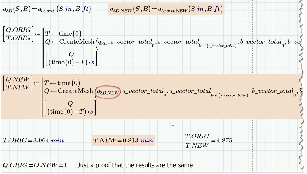

I have a completed Mathcad sheet that makes a 3D mesh. I am requesting to please help if the Q function that generates the mesh can be simplified such that the processing time is less. My version is 10.
Thank you

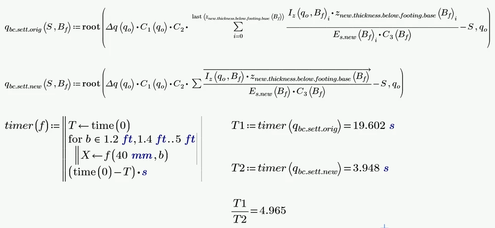

It looks like replacing the sum with index variable "i" by a vectorized expression can speed up the calculation by factor 5:
Of course, a similar speed-up factor can also be observed in the generation of the nested matrix Q.
See attached P10 file
