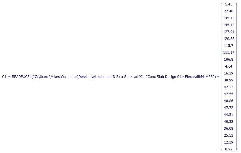

Jun 16, 2014 4:02 PM UTC
This should work.
Example in the attached sheet.
Jun 14, 2014 12:04 PM UTC
As I personally dislike the excel component my suggestion is to use READEXCEL() (and not READFILE()) as Mike alreadey suggested. You can "carve" the data in Mathcad using submatrix, as Mike suggested, but from what you wrote it seems to me you want to avoid is. Fortunately you can avoid this as you can specify the range which is read by using additional arguments of the function READEXCEL().
DataVector:=READEXCEL("D:\Data\Testdata03.xlsx", "rawData1!C12:C55", NaN)
Reads the range C12:C55 (default is: all Data) from the sheet named "rawData1" (default is: first sheet) in the file "Testdata.xlsx" (default path is worksheet directory) and assigns the resulting 44x1 vector to the Mathcadvariable DataVector. Empty cells are replaced by NaN (NotANumber) which is the default anyway.
