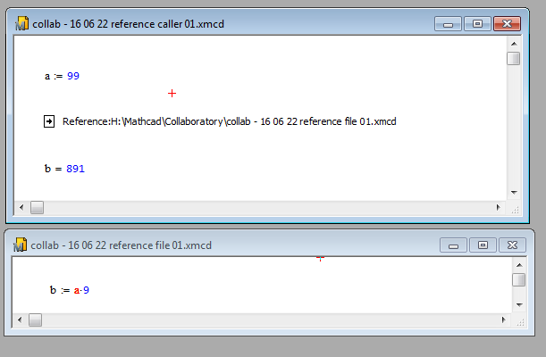

Hi, I am trying to create a mathcad file with another mathcad file as a reference.
I have test1 file with test2 as a reference using the relative file path. I am trying to pass a=3 from test1 to test2. it works when I first create the variables, however, the variable doesn't update unless I close and reopen the sheets. I already tried the recalculate button.
Is this a bug or is there some problem with the way I am doing it?  Thanks

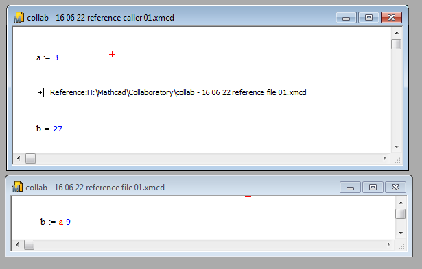

It should work, as Fred says, if you don't redefine a inside test2 before you want to use it.  Here's a simple example (Mathcad 15):
See if the attached worksheets do what happens above ...
Stuart
June 22, 2016
If you reference test2 in test1, what is in test2 affects test1, but the reverse is not true. If you open a copy of test2 it is just a standalone worksheet. If you want to pass a=3 from test1 to test2, then test2 must reference test1.
