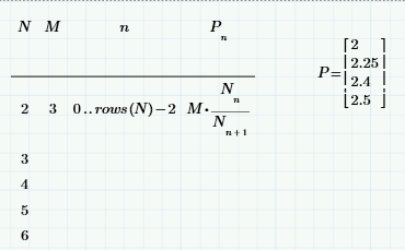

You mean something like this?

The issues is if the first column is N, the second column is M, the third column is P equal to M*Nn /Nn+1. This could be gear ratios and the ratio between ratios.
Is there a way to do relative addressing?

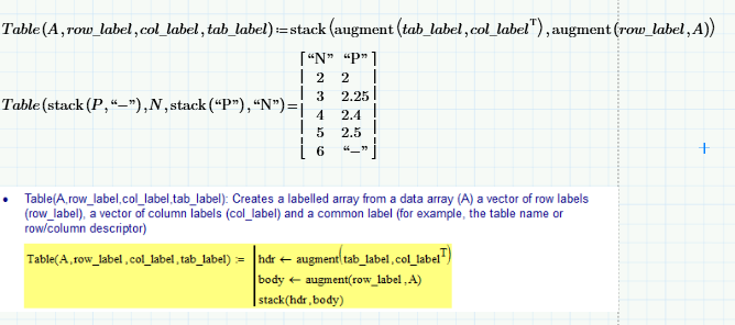

OK.  What I suspect you're really after is a "spreadsheet" way of relating the columns; that is, writing an expression for the value of P in each "cell" of the table, where the expression depends upon the "row number" of elements in another column, and then displaying the result rather than the expression??
If so, then the answer is that you can't as that as a table isn't actually a spreadsheet-like table. As stated above, a table is just another way of writing a set of (possibly related) Mathcad statements.   So anything (well, almost anything) you can write in Mathcad normally, should be capable of being written in a table.  So, in your particular example, we'd have:

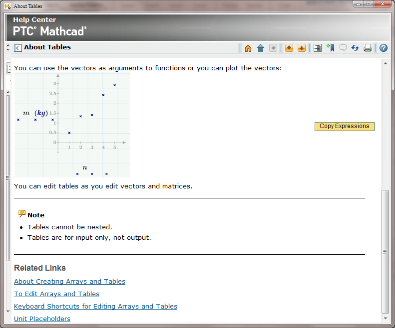

As Luc points out, a Mathcad table is just an alternative form for Input of expressions; Mathcad does not allow you to output data in table form.   So once you've got the data, you have to find an alternative method of formatting the data how you'd like it.   I occasionally have the need to display data in tabualar format with heading; when I do I either use Excel or a simple Table function like the one below (transcribed from Mathcad 15 into Express (which lacks programming)).
(Note that I had to manually adjust the size of P to make it equal in length to N ... the advantage of Excel (and the new Prime table input method) is that I don't have to worry about that particular detail)

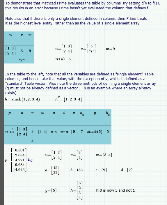

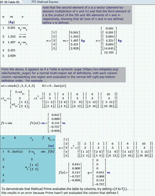

Following on from Luc's reply, it appears as if a Prime Table is effectively a shorthand method of defining a set of variables, where each variable can be a scalar, array or function.  Prime evaluates a table in the the standard left-right fashion, but does it column-wise.   This means that in any given column you can reference any variables (columns) defined to the left of it in a Table, but not any defined to the right.  You can independently reference any element of a variable as per a normal array.
I don't know whether this is documented anywhere .. I just had a play with it.

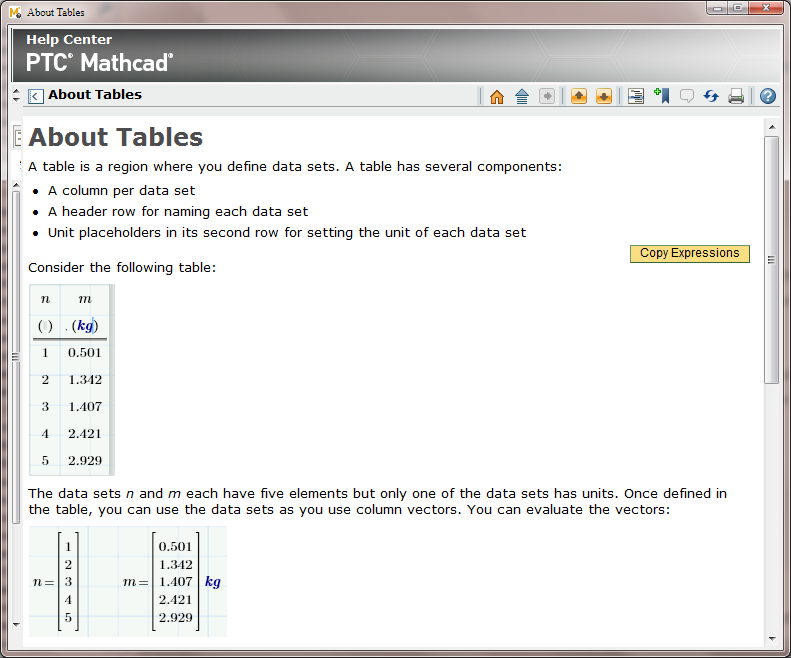

With regards to documentation, just look it up in the help:

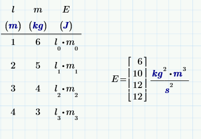

And so, I think this is what you want:

Unfortunately, I don't think that the documentation makes it clear what's going on in a table definition.  It (to me, at least) gives the impression that the columns must be scalars and does not make it clear that there is a left-right column order for definitions or that operations can be carried out on "already defined" variables (Table columns).   There was a bit more in my original worksheet pointing out that a Table treats a single element in a column as being a normal definition, rather than as a single-element vector.   I've updated the worksheet to show how to define a single-element array using Table.
