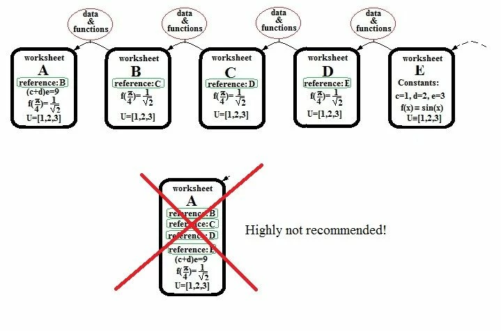

You must respect the following chart.
Constants and variables defined in a reference file, must not be redefined in the program that makes use of the reference.
