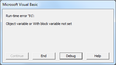

Now, I am trying to make this code run inside the Mathcad embedded excel file by coding it there. However, I am confronted with the error:
I am thinking that maybe I cannot refer to the embedded sheet as simply "Activesheet."
Can anyone help me sort this out?

Try Shapes("Picture 1").Visible = True/False instead (note no dot preceding 'Shapes').
Stuart
