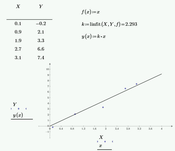

Regression line with intersection at zero
I have a dataset and would like to know the trendline with intersection at 0.
Is that possible?
Regards Jakob
Aug 4, 2014 10:47 AM UTC
Yes, Please show your dataset.
Aug 4, 2014 11:03 AM UTC
One way:
