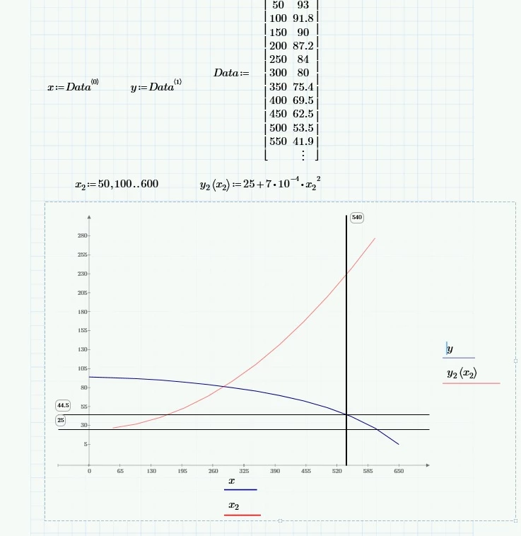

I am having a set of data that I have plottet in to a X-Y plot. But I would like to know the equation of these data, so that I can calculate the point where they are crossing each other. I have tried searching around both in this forum and other sites, but I have not been able to find a solution.
I have attached both a jpg file and a mathcad file.

You have a lot of regression curves to choose from.  Once you have the equation, solving for the intersection is easy.
Could you be more specific on how I have to do it. I am totally lost. Those guides I find online seem very complicated compared to my level. I thougt I could just choose polyfit(x,y) and then it would give me the function.
Polyfit makes it a little simpler, but it doesn't change much.

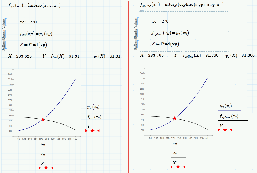

Using linear or spline interpolation you won't see an explicit equation but you can use the result like any other function:

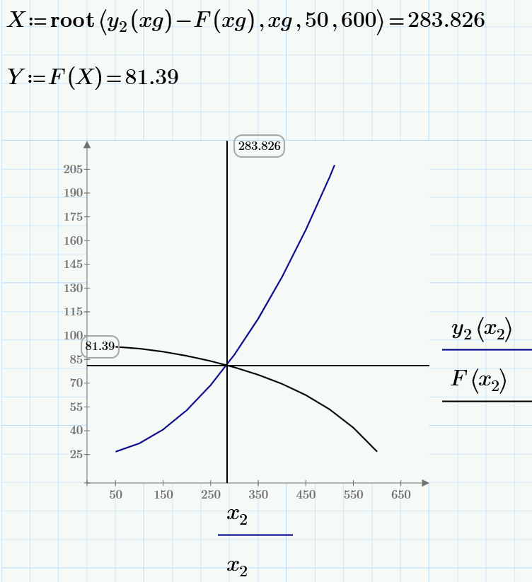

If we have one equation better use not the Find but the root function
Root sure is an alternative, but I don't see why it should be "better".
Unless you are using Prime Express and can't use a solve block, of course.

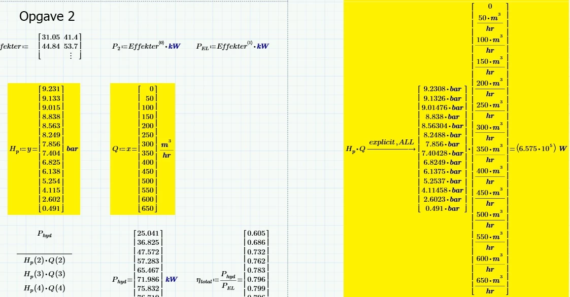

I have found another another problem in MathCad. I can't multiply two matrices? It seems like instead of multiplying it is adding all of the numbers in the matrices each of them and multiplying them afterwards. I have no problems if I am dividing them?
I have attached a file showing imy problem. I get only one solution. Instead of a solution for each row?
You are multiplying two vectors and what you get is the scalar product - so all ist OK.
You want a vector as result where the first component is the product of the first components of the two initial vectors. Thats not what matrix or vector product ist meant for from a mathematical point of view.
But Mathcad has a solution for this which is called vectorization. You have to vectorize the product (matrix palette, they symbol is the right arrow) to get what you want to see.
