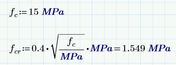

I'm using MathCAD Prime 3.0 and when I try to use the following equation, the units show incorrectly.
MathCAD is displaying the units correctly, as f'c has units as MPa and MathCAD is showing (MPa)^(1/2), but this is incorrect for that equation.
The equation is emprical and should have a result in MPa.
How can I remove the units (and just insert some text in their place), or specify units for this equation.
Thank you!

The problem with empirical equations is that each variable in the equation has some assumed unit, and the result has some assumed unit, but the units in the equation do not necessarily balance. You can fix this in Mathcad by dividing every input variable by it's assumed unit, and multiplying the entire equation on the rhs by the assumed result unit. If that's not clear, please post a worksheet.

This method works great, except that I had troubles with temperatures. Basically, K is the only temperature that actually works. If you manipulate other kind of temperatures, you will get in trouble because of the offset. To make your variable unitless, you shoud use instead :
(MyVariableInCelsius - 0°C) / (1K)
(might be slightly different for Fahrenheit, I haven't tried)
I have only seenthe problem with temperature, but there might be some other cases where the unit you use has an offset compared to the SI unit.

You can assign units to the emperical constant. Mathcad will then return correct units and perform unit conversion properly.

It works nicely in this case, but in many cases that I encounter, you are better off stripping the units off the variables, and assigning the right unit at the end, like Valery did.
Example : the power losses in the magnetic core of a transformer.
P(f,B)=k f^x B^y
f in Hz
B in T
P in W.m^-3
k, x and y material-dependant coefficients, and x and y can be anywhere between 1 and 5 (1.9 and 2.35 are perfectly normal values, for instance).
With this kind of equation, you are much better of assigning W.m^-3 to k, and using (f/1Hz) and (B/1T). Otherwise, not only is it difficult to work out the unit of K, due to the fractional exponent on the frequency and magnetic field, but it also means that you need to re-check and re-type all the units when calculating for a different material.
Personally, I would strongly recommend Valery's method, that is more generic,allows for error checking (includes units), and more re-usable in complex cases (stupid exponents on units, exponents that can be variables, etc).
