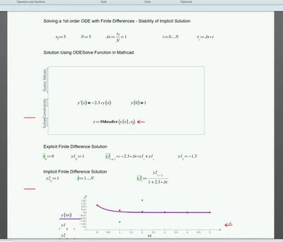

Hi Folks,
I'm converting V15 files to run in Prime 8, but can't figure out out to remove the red arrows and red lines.  The file runs.  Right clicking on the arrows doesn't do anything.  I can't find anything in the online documentation.  I must be missing something.  Can anyone enlighten me?
Mark

There is a menu selection that will remove all conversion issue arrows - "Clear Annotations" right next to the "Converter" button.
mfrench13-AquamarineAuthor
Thanks very much.  I had missed that.
