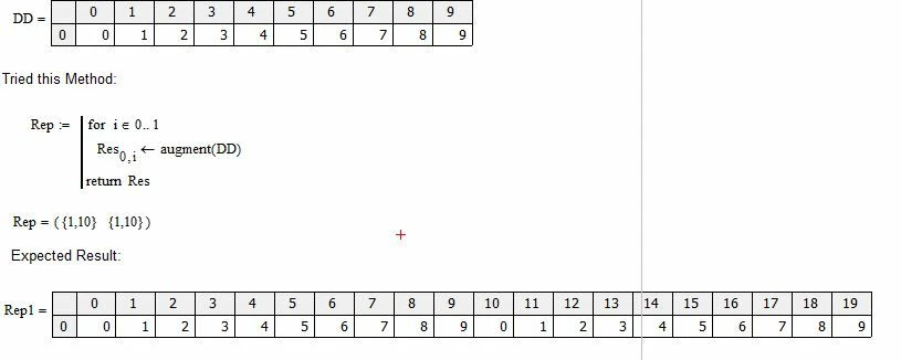

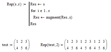

hi, i need it in programming, like this,

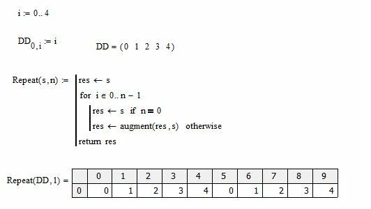

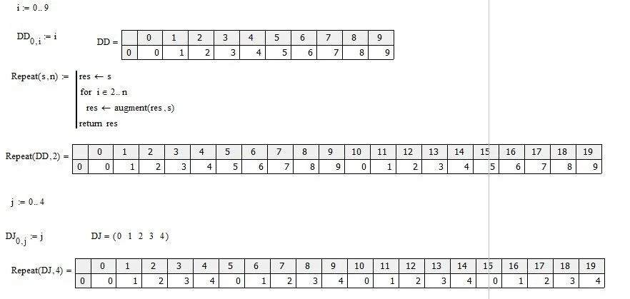

maybe that way:
23-Emerald I

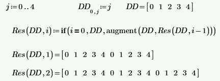

You can use recursion:

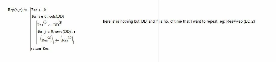

I can't use this approach in Mathcad 15, Pse guide & do the needful.

This will solve, thanks everyone for suggestions,
