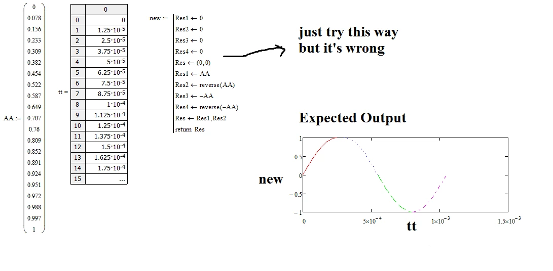

how to plot repeated value ?
Eg:

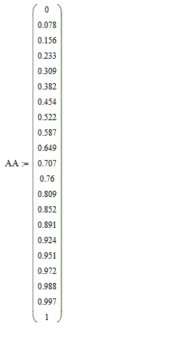

for example i want to plot sin wave, i have values for 0-90 degree and i want to plot for 90-180 degree by reversing same data and so on till 360 degree or (0 to 2pi).
In the 1st graph, AA=[0,0.99,0.98,0.97,...1],size of AA is 20and i'm just repeating by modifying same data "AA"

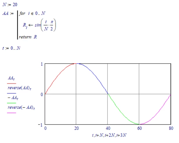

Best answer by terryhendicott
I think? the function you are looking for is "stack".  Doing this you loose the four colours.
I have generated AA from Sin as I am not retying your AA by hand.
Cheers
Terry

No, i don't want to use sin function ("sin") without using "sin" but using set of values like "AA" only,
Note: only values of "AA" and i want to do all the operations on programming it self not on graph,
Ex:

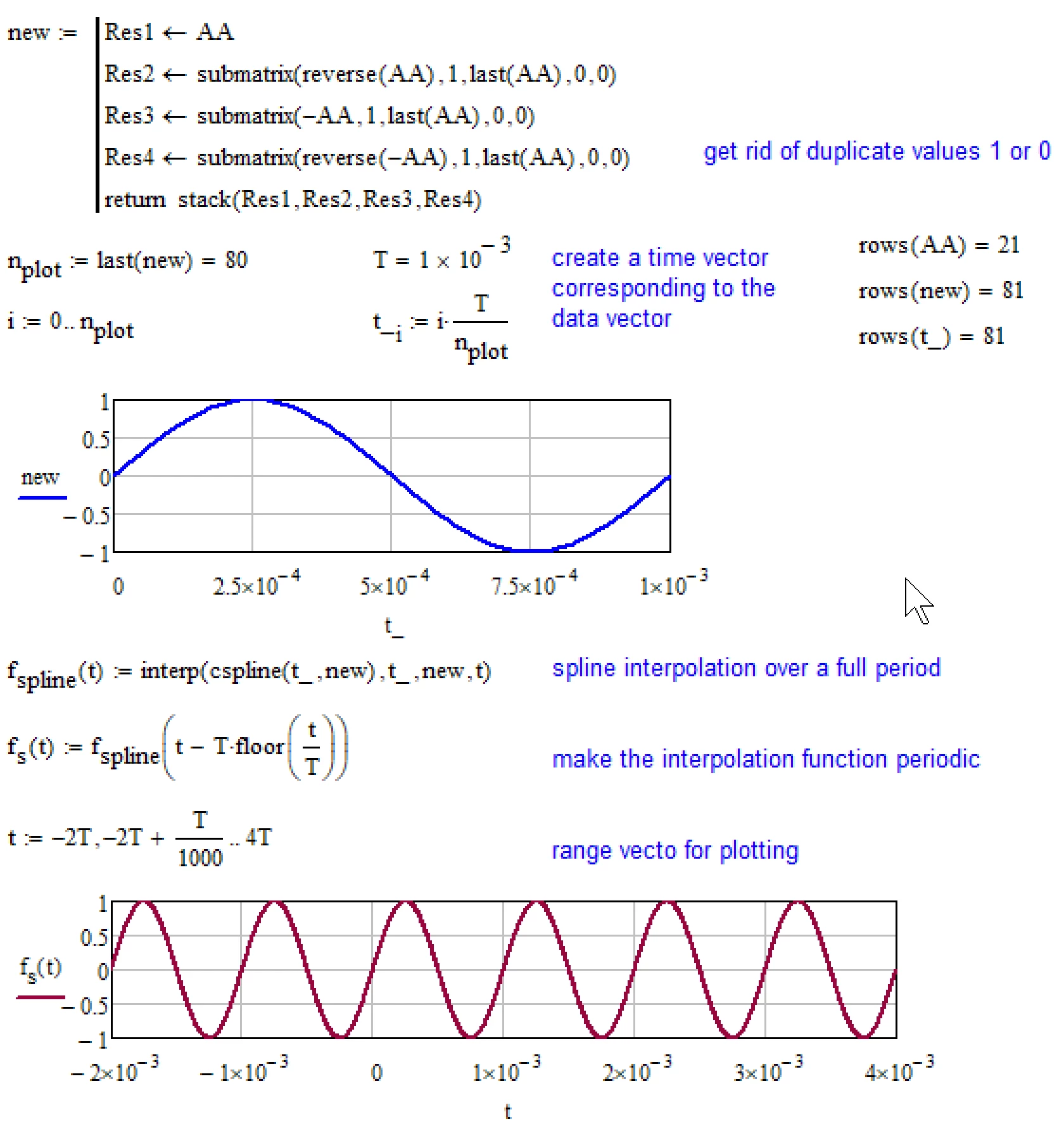

April 20, 2018
Like this then?
Cheers
Terry
