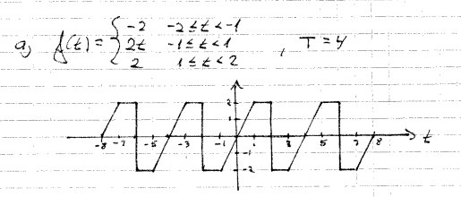

Though, I still have one problem.. I really can't figure out how to make a repeating periodic function.
An example would be the uploaded file, where I'm trying to make a function look like this.
Though I can make the function from -2 -> 2, I cannot figure out how to make it repeatable, like the picture.

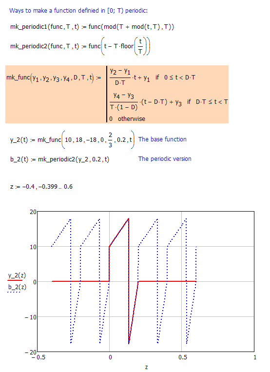

Here's a screen capture from MC15. Sorry, I'm too lazy to convert it to Prime
The MC15 file Richard is referring to can be found here: http://communities.ptc.com/message/234703#234703

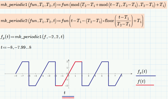

But both make_periodic() routines there assume that the base function is defined in the range of 0 to T, which is not the case here.
Find attached both routines modified so that you freely can specify start and end of the interval (in your case -2 to 2).

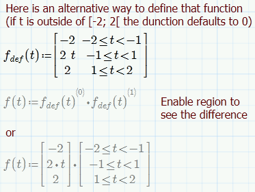

Your function definition was undefined outside of [-2; 2[. I changed it to return NaN for values outside that interval.
I also added another (unusual) way to define your function - it defaults to zero outside the interval (like the function Richard had shown in the pic).
