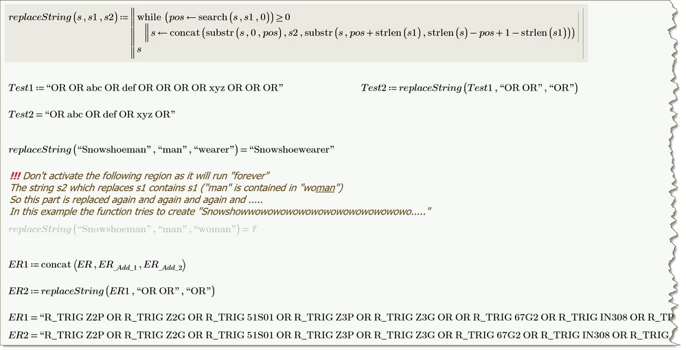

I have a character replace function.  I would like to use it to replace a string with a string.  If the user inputted duplicate "OR's" then I want the function to thin out "OR OR" to just "OR".
Thanks in advance

You may try this string replace function.

Mar 9, 2026 12:08 PM UTC
Thank You!  I learn so much from this forum!  Your suggestion works!

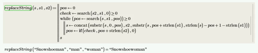

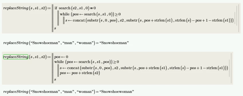

Mar 9, 2026 2:37 PM UTC
@Snowshoeman just do an initial search for "s1" inside "s2".  If it is, then return the original text so that you do not have an infinite recursion.  Or, like typical replace functions, keep track of the position of the last search and so that the replacement text does not itself get searched.  Here are both examples.
If you want the flexibility an exhaustive search while having the protection from recursion, then combine both function so that you keep track of the position only if there can be a recursion:
"check" remembers if "s1" is inside "s2", then in the 'if' function, "pos" is advanced if "check" is true, or it is reset to zero if not.
