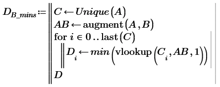

ttokoro
ttokoroAnswer
Feb 12, 2025 12:27 AM UTC
t.t.
ttokoro
ttokoro21-Topaz IAnswer
t.t.
8-Gravel
Feb 12, 2025 2:37 PM UTC
Thank you. Very much appreciated.

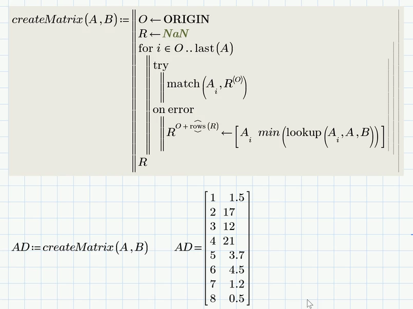

Feb 12, 2025 12:58 AM UTC
As an alternative here is an all-in-one utility function which creates the final matrix in one go - might come handy ...
8-Gravel
Feb 12, 2025 2:45 PM UTC
Thank you. This is also an excellent solution. I will use both this and the other solution posted in my calculation so that I can use one to check the other. Very much appreciated. Grateful for your help and yes, I am sure this will come in handy.  I also really appreciate the fact that you uploaded the Mathcad file.
