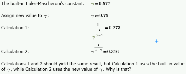

Ah!
I think I spotted it.
You are using Prime and the problem occurs because of Primes (auto) labeling "feature" - a major annoyance.
If you look closely you see, that the gamma in first and third expression is colored gray - this means its labeled as (built-in) constant.
The gamma in the second and fourth expression is colored black, so I guess its either labeled as variable or as "automatic" ( - ).
So you are working with two different gammas with different values.
Label manually accordingly to get the results you expected.
In Norms screenshot all gamma apart from the first are black, using the newly defined variable.

I didn't see that using Prime 3.1:
April 13, 2016
Which version of Mathcad are you using?
Post the sheet, please, so we can see, if we experience the same effect with your sheet, too.

April 13, 2016
Yes, it was a labeling problem. Thanks for helping, Werner Exinger. Kind regards, Henning Søgaard
April 13, 2016
Look at your labels.
Calculation 1 uses the "constant" label (note the green color).  Calculation 2 uses the "variable" (or "non") label.
April 13, 2016
You were right, it was a labeling problem. Thanks, Mark Gase. Best regards, Henning Søgaard
