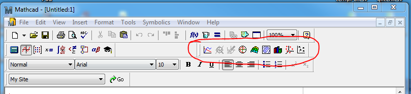

How do I reset my toolbar positions? when I undock my laptop my toolbars are no longer on screen how do I get them back?

select the toolbar that is on the second screen by clicking on the top (blue) bar & drag it as you can any window.
If you drop it on the main Mathcad page it will stay in this shape.
If you drop it on the tool bar area it will change back to its 'docked' form.
selecting the bar at the left hand side allows it to be dragged & moved on the toolbar or undocked.
Mathcad should remember the last placement (it shouldn't need any file to be saved)

As I understand it you work with your laptop at a docking station and use a monitor with a larger resolution than your laptops screen.
When you undock the laptop while Mathcad is still active and the display is switched to the laptops screen, floating toolbars might be inaccessible.
I don't know of any way to bring them in view or reset the layout to a standard one (whatever that might be).
But if you close Mathcad and start it again you should see those toolbars floating at the very edge of the screen but in a position which enables you to take hold of them and drag them to a new position.
At least that happens when I try to simulate your problem by changing the screen resolution to a lower one.
