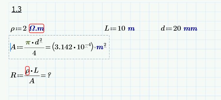

Hi there,
I am currently trying to write an equation in Prime 3.1 which includes resistivity.
For some reason it is not letting me put the units as Ohm-m and hence not letting me complete the equation.
Has anyone got any ideas how to over come this?

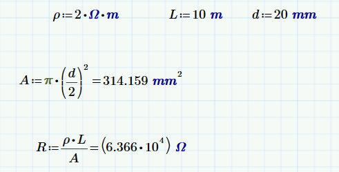

You have a period.  Try ohm times meter
