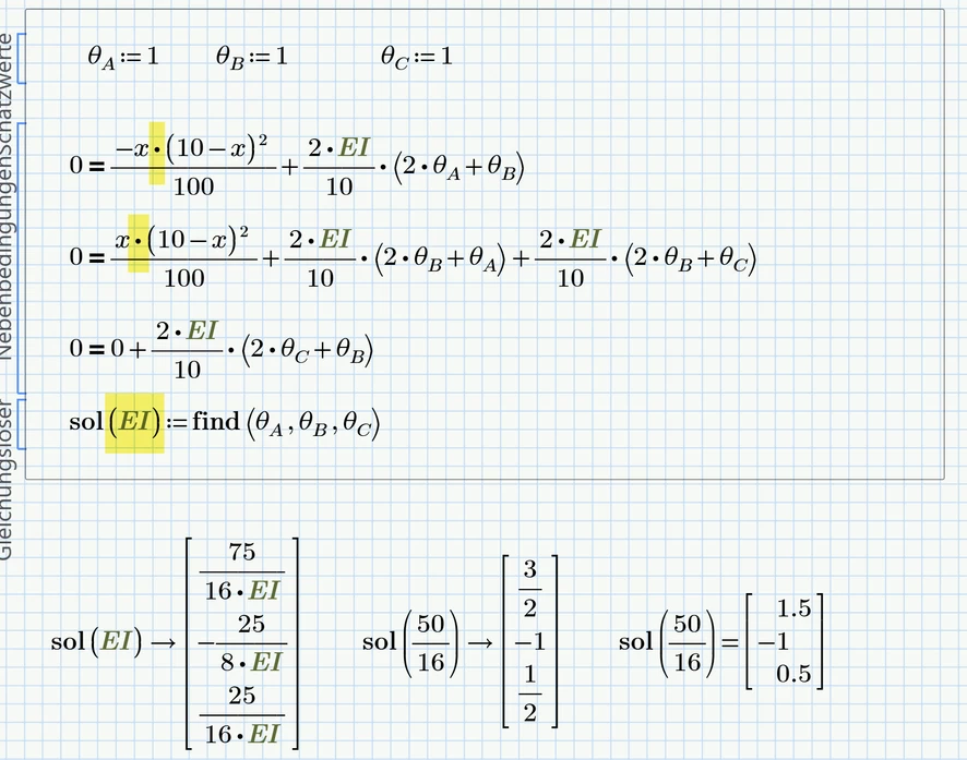

Good morning community, I am trying to solve equations that have variables and constants without success. Please if someone can help me. Thank you. Mathcad Prime 8.0.0 File

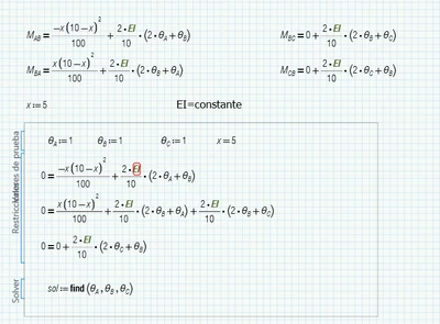

The error marked in red comes from the numerical system in Prime, because EI is not defined.
Therefore, the solution block can only be evaluated symbolically and not numerically. The error can be ignored.
I would also suggest parameterizing the solution block, i.e. running it as a function of EI. This allows "sol" to be evaluated later for each value of EI.
However, you have made a serious mistake: the notation x(...) in Prime means calling a function x. But what they meant is a simple multiplication. In this case you have to enter the multiplication point explicitly.

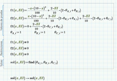

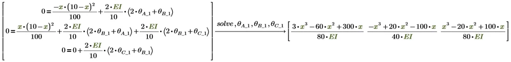

Agradecerle por la atención, En  este caso cual seria el error por que estoy tratando de probar con todas las etiquetas,. Seria tan amable de aclarar con que etiqueta se pone a cada uno. Gracias. Estoy trabajando con Mathcad Prime 8.0
