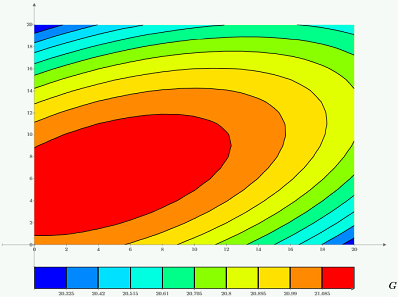

This worksheet shows you how to fit an empirical model with three variables, given by the Meyers and Montgomery paper (in reference).  To construct the response surfaces, you can hold one dimension constant and vary the other two.  A results matrix returns the:
