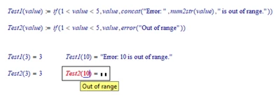

Does any one in the forum know if Mathcad can be used to evalate a result and report if the solution is placed outside a predefined range.
For example. I expect to recieve a result between 1 and 5. If the result ends up in a value of e.g. 10 I want to be able to read that the result is out of range. Preferably in a warning message.

You can do this with a boolean test in an if statement.  Mathcad will not pop up a warning message as if a system error had occurred.
LucMeekes23-Emerald IVAnswer
January 13, 2020
Two (of the many) possible ways:
