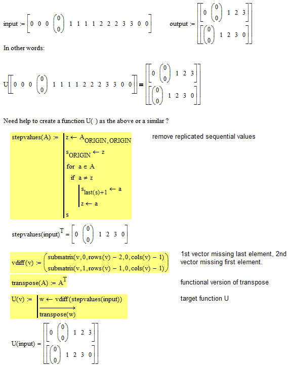

  Hello, Everyone.
  Need help to create a function U( ) as the above or a similar ?
  Thanks in advance for your time and help.
      Regards. Loi Le.

Obviously duplicate scalars are discarded but you sure would have to provide criterions how and where to split your vector into two (ore more?) subvectors.
September 20, 2015
Or are you rather searching for something simple like this?

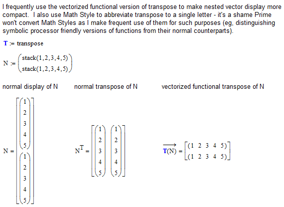

By coincidence, we had a thread recently on one part of your problem, that is removing duplicate values whilst preserving their order of occurrence.   It looks like a chance to reuse some code here and add a couple of other functions that are generally useful (or, at least, I keep writing versions of them!):
I've used vdiff for calculating the difference between successive elements in a vector (but only when I've had another need for the 2 vectors!).  I frequently use the functional version of transpose to make vector display more compact by vectorizing it over a nested vector, as the example below hopefully demonstrates.
Stuart
