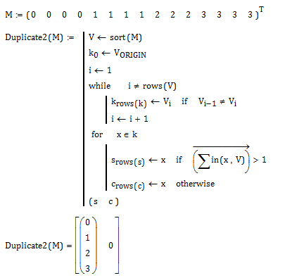

Slight alternative to Stuarts method using a while loop.
Mike

hello Mike,
Thank you very much for your response.
Are the elements of array: Duplicate3(M)=(0 1 2 3) taken from the last value (I underlined below) of each similar sequence? or arbitrary?
M:= (0 0 0 0 1 1 1 1 2 2 2 3 3 3 3 3 3)
If no, how can we know that?
And is the commande V<-- sort(M) is used to sort M?
If yes, I dont need this because I want an array randomly , like N:=(0 0 0 8 8 8 8 10 10 10 5 5 5 5 5 5 1 1 1 1 1 1 1 )
Thank you very much,
NGUYEN

A slight alternative which will return the duplicated values and non-duplicated values. No what was requested but could be of some use.
Mike
