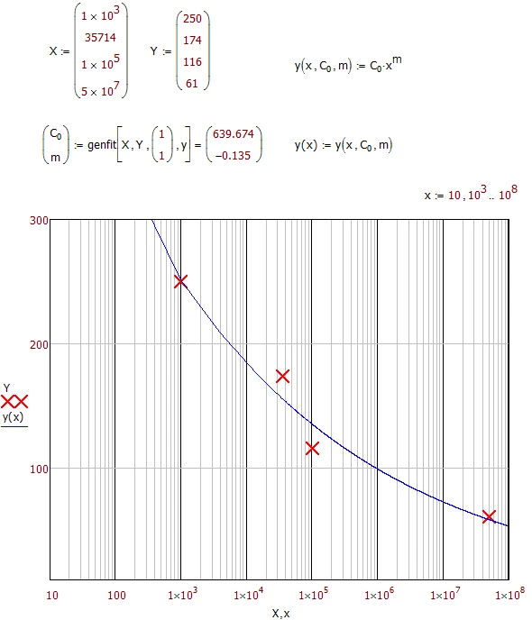

Given the set of 4 points is there a way of returning the coefficient C0 and m of equation y(x)=C0x^m for a best fit?

Not sure if its the best way, but heres one way to do it.
You may also use a solve block with minerr which may give you more flexibillity.

Thanks. Starting to get a grip with the 'genfit' function
