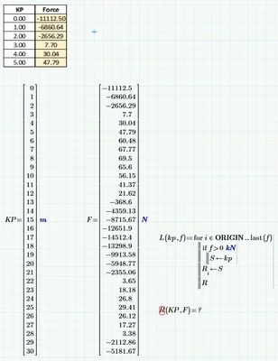

Return only the KP value when F is greater than 0
Dear All,
I am trying to write a program to return the only KP values when F is greater than 0.

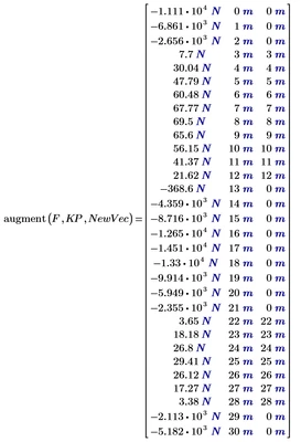

We can use a table built with augment to check the results

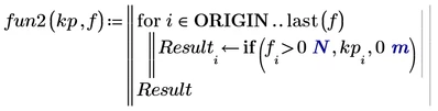

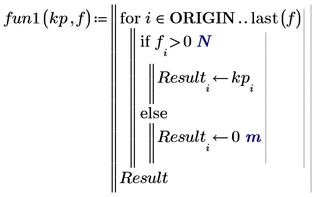

And here is a more "natural" approach with a function using a for loop
You can replace the 0m by NaN or whatever may be appropriate.
We can check if both ways return the same result

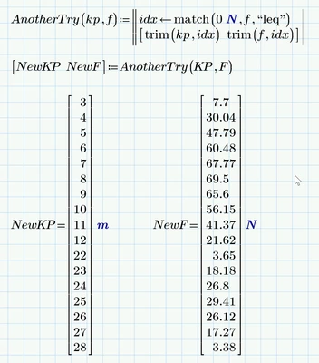

I would like to add also a function to filter to return only the KP where F > 0 and another matrix showing the only F > 0 values.
Jun 19, 2023 1:05 PM UTC
Examples always would be welcome to clarify what exactly is needed.
A I understood it now you want the values in both vectors removed when F is zero or negative so only the positive values in F remain and also the corresponding values in KP?
Could be done in many ways, one is shown here
