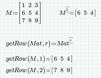

Hi there,
The title says it all. I want to try to return a row of a matrix with a little MathCAD program.
December 19, 2016
You don't even need a program for it, just an expression:
But if you want to make a function of it:
Success.
December 19, 2016
Its even easier if you use Prime as we have a new row selector here:
