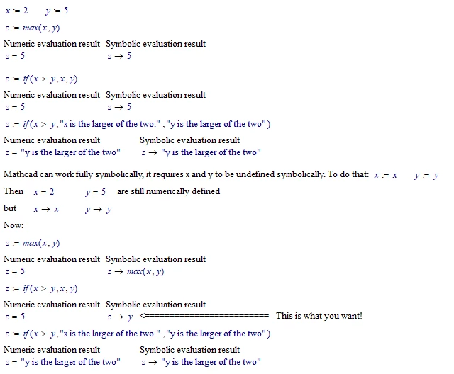

Hmm. I tried to demonstrate it was not possible, and found that it IS possible in Mathcad 11:
 But I have my doubts on the usefullness of this, and on whether it works in Mathcad 15 or Prime.
Succes!
January 27, 2018
It doesn't work in Mathcad 15, so I very much doubt it works in Prime.
