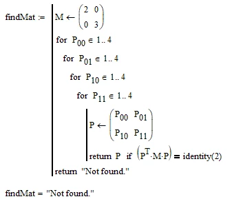

I have tried to write a Mathcad Program for this purpose. But the problem is that, neither it is returning the whole array of matrices, nor the one output that it gives is correct. It is returning A instead of P. The image of the Mathcad Program is:
Please, if anyone can help me in returning an array of matrices that satisfy the given condition, I would be obliged.

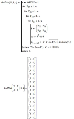

Even no solution contains a zero element, your loops should start from 0 and not from 1.
Note also the by default (you can change that behaviour) arrays are numbered beginning with 0, thats the reason for "i <-- 0". To apply the modulo operation on every element of the matrix T and not on the matrix itself (which makes no sense and results in an error) you have to use vectorization (the arrow over the expression). The temporary matrix T is necessary because we cannot write
because if we do so, the matrix multiplication would be done element by element and not the correct way. Se the difference here:
So here is one way to find the solutions via brute force:
P6 file attached

Hmm,
The one output it gives is for the last matrix P tried. That is:
due to the fact that you did not build an escape into your program.
Did you check this:
No wonder:

As Werner has shown, you have to use the mod function:
