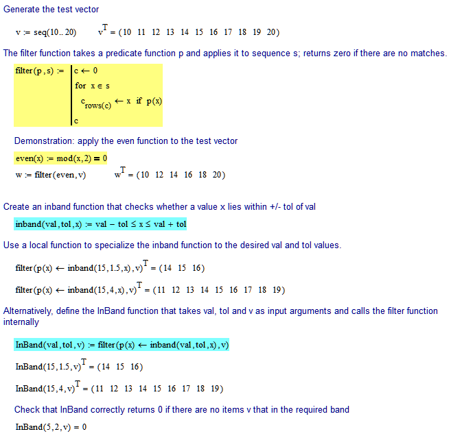

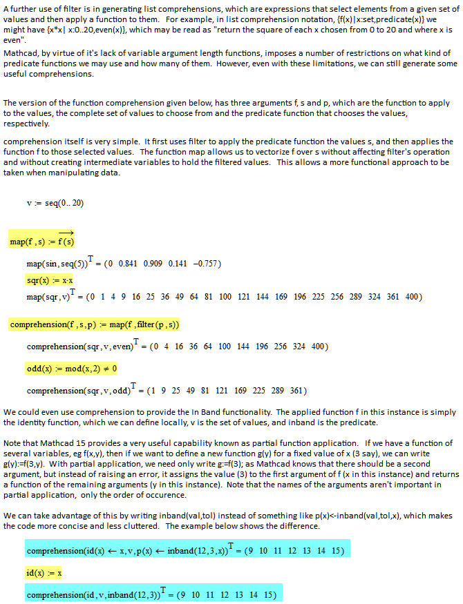

And here's another way that makes use of a more general filter function, which you can use anywhere you want to pick out just those elements of a vector that meet a simple yes/no test.  filter returns 0 if there are no in-band elements, as 0 corresponds to logical false and hence can be simpler to check in many instances.
Here's an example of how filter could be used ...
Stuart
23-Emerald V
November 19, 2015
Forgot to add the partial application version of InBand ..
And the direct definition of the tolerance function inside filter
Stuart
