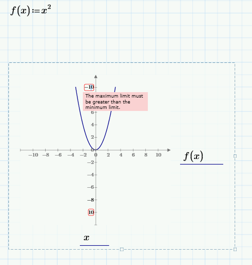

I wish my email finds everyone happy and sound. I need to reverse the scale in a graph that I have attached . The graph is z vs u(z). I need to start the scale values in the graph form lowest at the top and highest at the bottom. I will appreciate if you can help me with this.

In Prime there's no way to do that. It insists that the maximum limit be greater than the minimum limit.

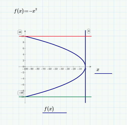

The only trick you could do is to plot -z versus u(z).

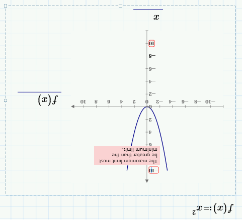

September 26, 2016
jajaja. Do you try to go to the south hemisphere?. Once there, you can ask someone in the north to take a photo of your monitor.

Faisal,
Did you meant this?
Hope this was helpfully.
