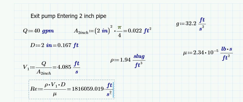

I am doing calculating the Reynolds number in English units and I am getting units with it.
I can't figure out why either. I would appreciate some help.

Use lbf rather than lb in viscosity.

Reynolds number is Velocity (ft/sec) times Length (ft) divided by Kinematic Viscosity (ft^2/sec).  You are using Dynamic Viscosity.

Thank you. It shouldn't surprise you that it worked.
