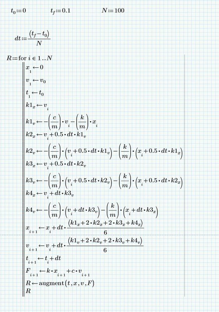

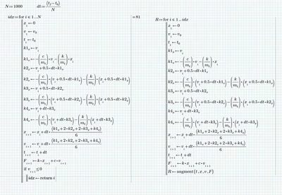

in the attached sheet there is a problem of mechanics of a damped system
Unfortunately I couldn't use odesolve, so I tried RKfixed, but again I got an error message from Mathcad. So I did a manual RK4😅
Could someone help me use the Prime RKfixed? it would be more elegant than what I did😂
and also to stop the loop when "v" (speed)  becomes negative,
after that continuing the iterations no longer makes physical sense, at least when x<0. Since at that point the load has passed through the damper
also, all attempts I made with the units failed
Differential equations are not easy for me😂

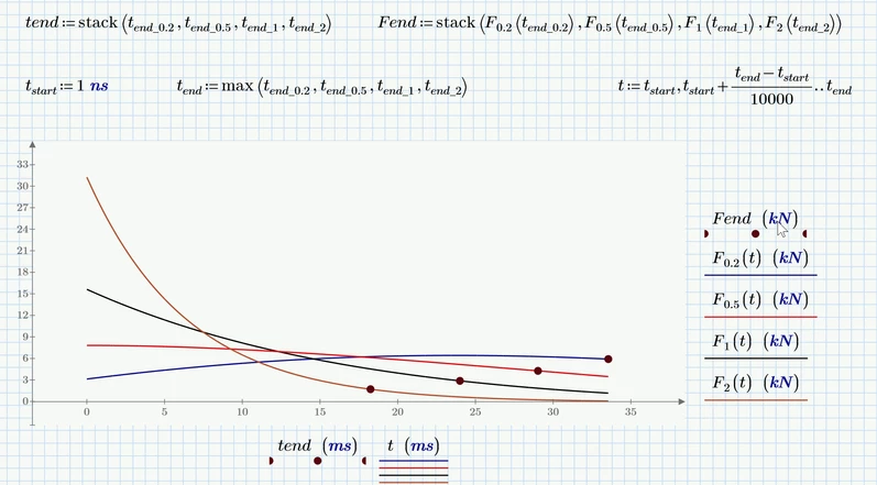

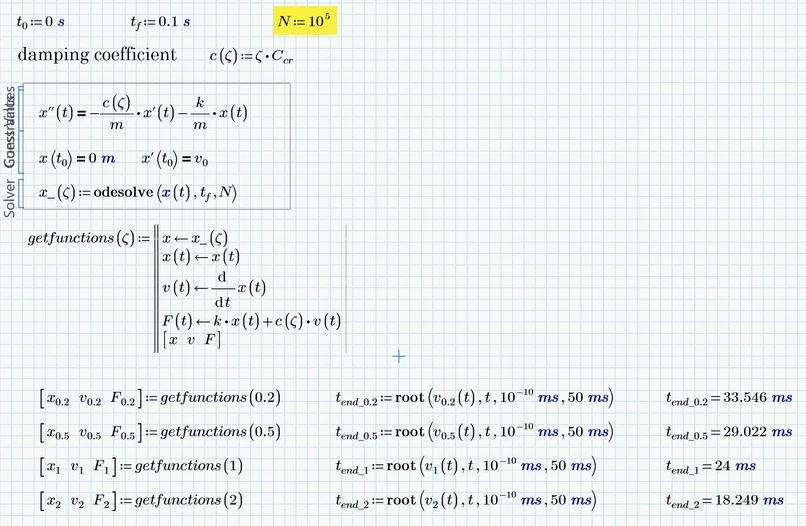

Here is a way to turn the solve block with odesolve into a function of zeta, so the outcome of different values of zeta could be compared side by side.
Not sure why the line x(t) <- x(t) in "getfunctions" is necessary, but if its omitted Prime throws an error.
EDIT: Just gave it a try and that's a bug in Prime 10 which is fixed in Prime 11.
Prime 10 sheet attached

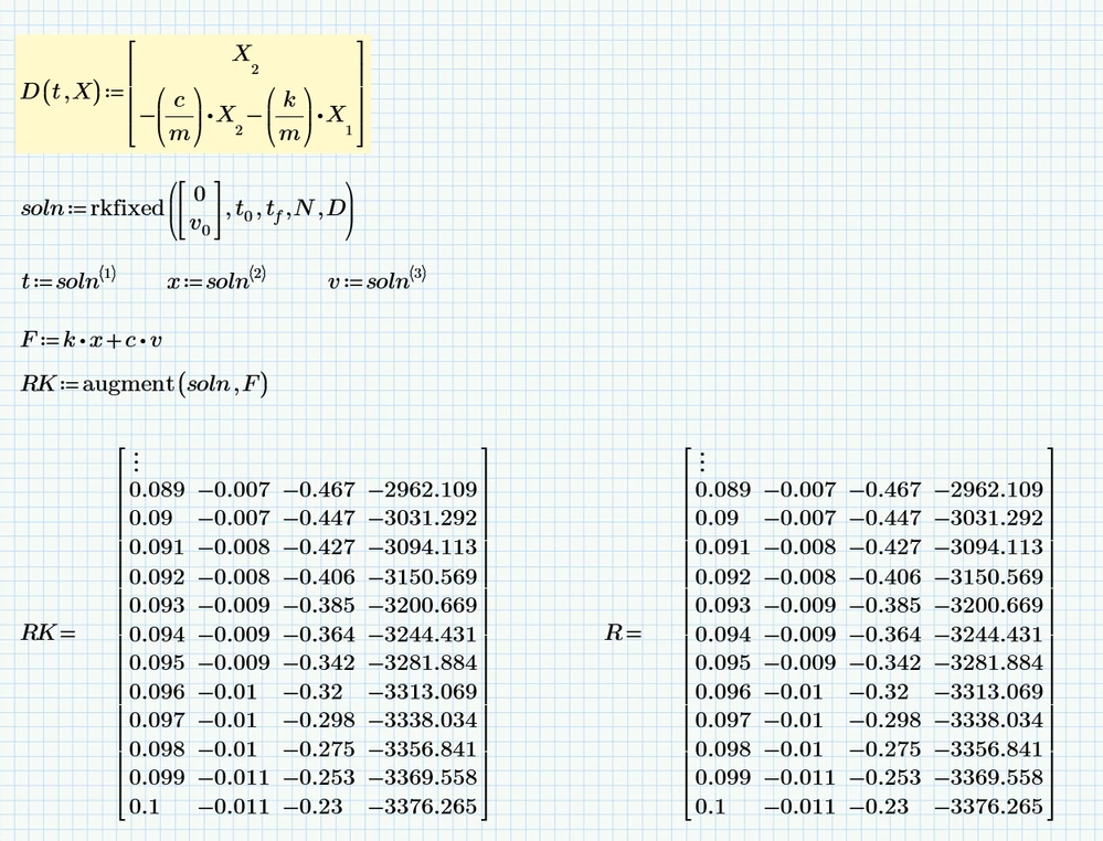

It would be helpful if you could post your 'failures' as this might allow us to aid you in getting the results you want.
However, looking at your worksheet, I'm guessing that you're having difficulties in defining the differential equation in a form suitable for rkfixed?
Your DE can be expressed as shown in the image below.  It seems to get the same values, anyway!
I've attached a Mathcad Prime 11 worksheet with the rkfixed solution.

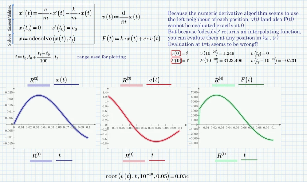

As Stuart already supplied the RKfixed solution, here for completeness sake the solution using a solve block with "odesolve".
As you can see in the plots the results pretty much match the results your program returns.
If you are interested in the position/time where velocity v gets zero, you could use the 'root' function (see at the bottom of the pic).

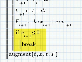

EDIT: Because you also asked how to stop the iteration in your program when velocity gets negative: You could use and if-statement and trigger the break command. This will leave the loop. The value your program should return therefore must be placed outside and below the for-loop. There is no need for a local variable R.

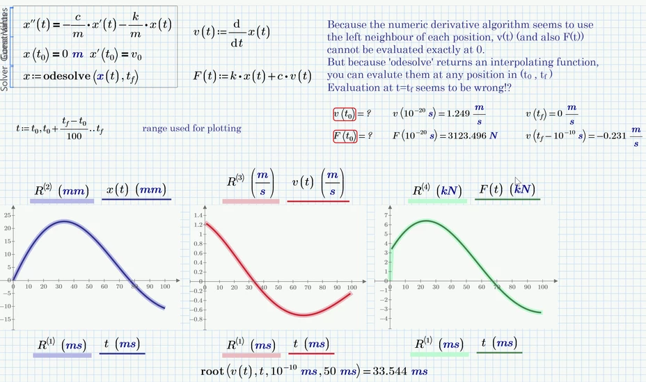

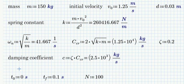

Because you wrote that you had trouble using units.
I applied units
and both your program as well as the solve block with 'odesolve' work OK.
But because you used variable "m" for mass you have to take great care when you type "m" to use the correct label - either 'Variable' if you mean mass or "Unit' if you mean meter. After you define your mass Prime will default to 'Variable' when you type m and you would have to change it to 'Unit' manually (easily done by pressing Ctrl+U).

The model with odesolve is much more elegant than my manual method. Yes, I need to stop my loop when a certain condition is reached, here v<0. However, I need to keep the matrix of results calculated up to this stopping point. So I duplicated the loop by keeping the index of the stop, then restarting the loop with an index limited to the stopping value. I left the calculations for x and f , because if necessary I can choose a conditional stop other than v , but it's detail
This is a crude method, but it gives the matrix of results I need to extract the extrema.
However, by varying the parameters zeta or t, my manual model diverges from the odesolve model. The larger zeta becomes, the stronger the decorelation becomes.🤔in fact it happens quite early
so I assume an error in my model and I prefer to trust your model

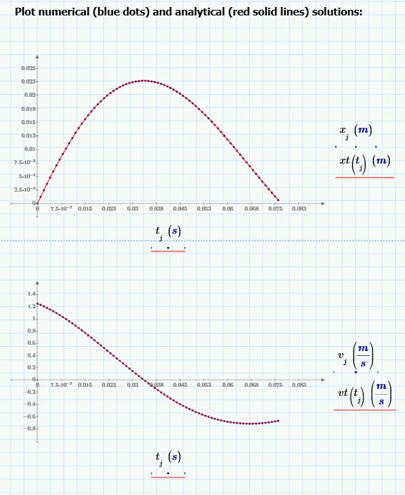

I decided to use this problem to see if I could develop a 4th order, fixed step, Runge-Kutta routine for use with Prime Express (as Express versions have no ODE solvers or programmable facilities).  The solution I’ve developed is very inefficient, but the inefficiency isn’t really noticeable for this toy problem.  The result compares well with the analytical solution.  See attached.
Alan

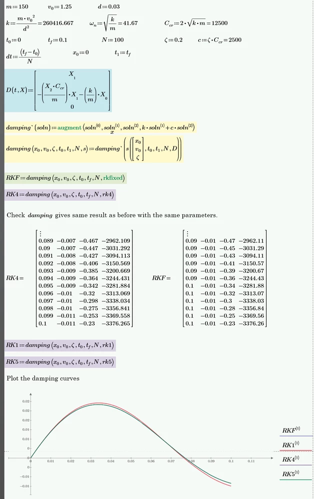

I thought I'd posted an Express-friendly (well, less-hostile) version of an ancient Mathsoft Mathcad 7 ODE library.  Can't find it, so I probably didn't.
Attached is a very much tidied-up version of the MPE7 worksheet I found skulking in my folders.   It covers the first five Runge-Kutta fixed, single step ODE solvers (rk1 and rk2 are equivalent to simple and improved Euler, respectively).   rkfixed seems like overkill for the problem at hand.
Stuart
