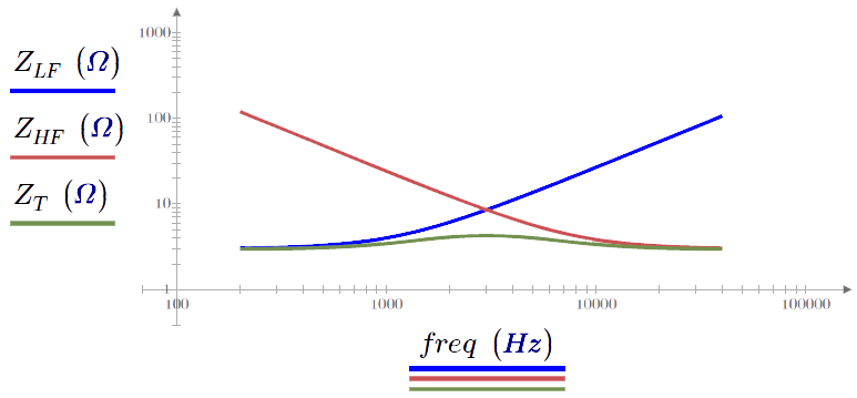

About this worksheet:
  • Calculates the impedances across frequencies in a RLC passive crossover network
  • Applicable in electrical engineering, electronics and high-tech industries, speaker design
  • Performs using Excel, frequency, resistance, capacitance, inductance, angular frequency, reactance, impedance, etc.
This worksheet using PTC Mathcad includes an example of an engineer designing a hi-fi speaker that must meet a certain frequency response. The horizontal trend must be over the whole spectrum of the audible range with a tolerance of +/- 1dB. Because at least two transducers are needed, you must look at the case in which there is both a low and high frequency driver. You can calculate the impedances of each to determine the overall frequency response.  This worksheet uses data from excel and plots the solutions.

Hi Luc,
With your helps, I was able to plot the RC circuit in frequency domain. The problem is I would like to have the minor and major X-axis in log scale. How do you do that?
I searched in this Forum and found a solution Grids_for_Prime.mcdx, unfortunately it is a mess and I do not have a clue what is going on. Is there a better solution to plot log scale on the X-axis? Y axis is linear so I do not have problems with it.
