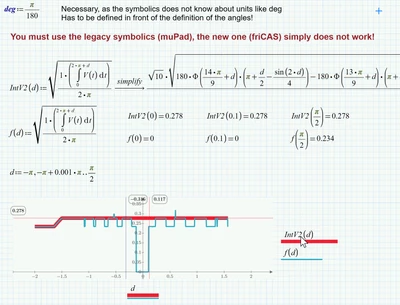

How about this approach?
Note that you must use the old legacy symbolics (muPad). It will not work when using the new friCAS.
Worksheet in P6 format attached.

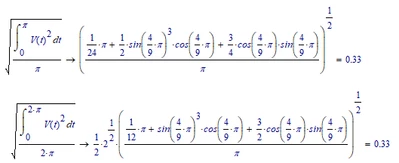

Mathcad and Prime never had much luck with integrals, neither symbolically nor numerical as in your example.
Defining the function in a different way like the two shown in the pic does not help much:

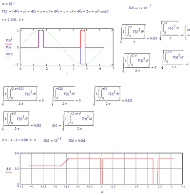

October 17, 2019
Not necessarily restricted to Prime 6, Prime 4 shows the same.
Mathcad 11 too:
The value of TOL has some effect.
As usual, symbolics is right:
How is that in Prime?
October 17, 2019

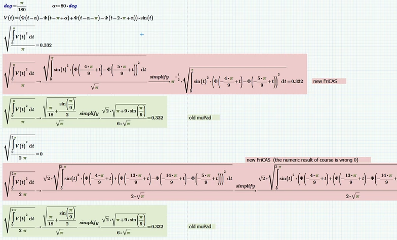

Here you are!
I gave it a try with Prime 6 using the new and future symbolics (friCAS) and the old one (muPad). The new symbolic is not really convincing. The simplification of muPad is (even without using simplify) even more compact than your Maple result 😉

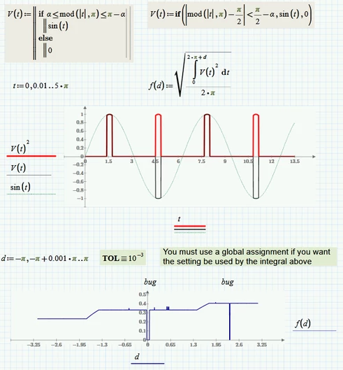

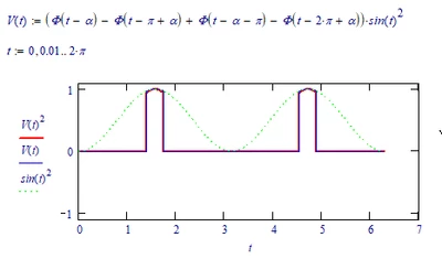

October 17, 2019
you shouldn't square the function containing the Heaviside function but only the function defined in the window created with the step function. See the picture:
don't square U(t). However, the rms is still zero.....

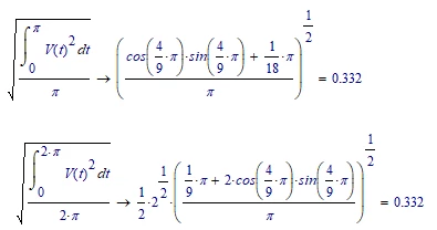

October 17, 2019
Squaring the sine 'within' gives you a different function:
with a different symbolic result:
but numerically it's still flawed...

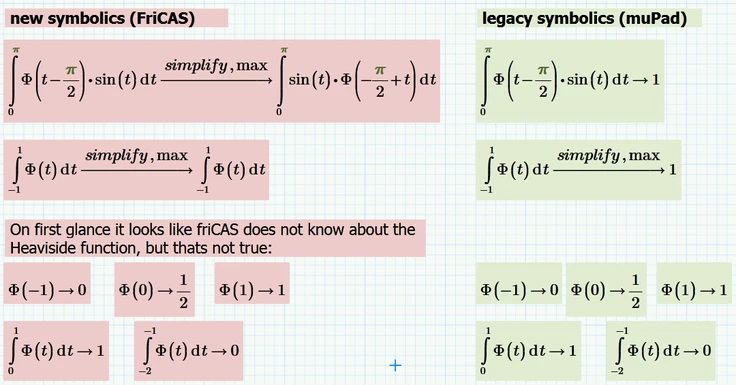

October 17, 2019
I think you misunderstood what Francesco meant.
The idea was not to replace V(t) by his U(t) but rather replace V(t)^2 by his U(t).
I am not sure what the benefit of doing so would be, though.
BTW, here is more clearly the deficiency of the new symbolics (friCAS) in Prime when it comes to integration with the Heaviside function with the step inside the integration interval:
We always moaned about Prime would not be developed (or not fast enough). Replacing the very old symbolics engine muPad by a new, more modern one sure is a good a big development step. When we moaned in the past about development, have we forgot to state the direction in which we would like to see development taking place? We did not meant the direction of making things worse!!

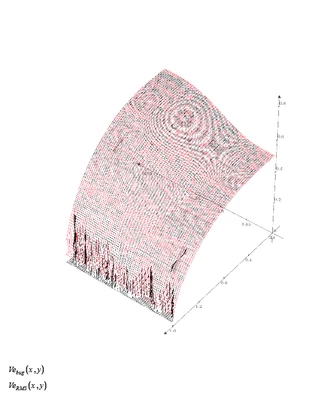

October 18, 2019

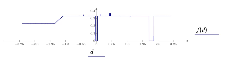

image.pngUsing 3D plot, the bug region is visible.
For Fourier analysis, if the signal is f(t)=-f(t+T/2) integral from 0 to pi is OK. Otherwise, we should integral from 0 to 2*pi. Therefore, this bug is sever problem.

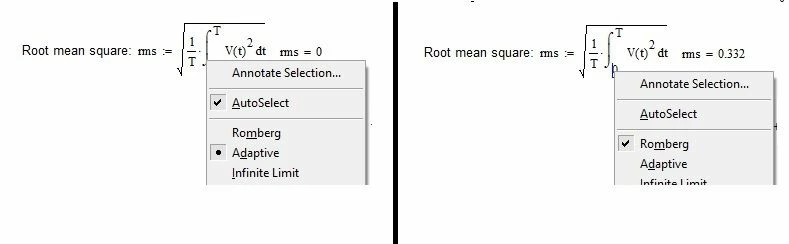

October 18, 2019
Mathcad 15 gives almost the same results. However, if we change the integration algorithm the result is not null; see photo:

October 18, 2019
Attached is a slightly different approach (Prime 6.0)
