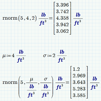

I am trying to use rnorm to create a vector of random numbers.
The vector should have (density) units of lb/ft^3.  For some reason when I attempt to give the sigma and mu values units of lb/ft^3, the numbers come out incorrect and without the desired units.  Where should I look to fix this?

That's because the default units in Mathcad are SI units. Your inputs (mu and sigma) are provided by you with units. Mathcad translates them internally to SI and then generates the list of random numbers. Unfortunately the random number generator is not designed to handle units, so it simply forgets them. You get a vector of unitles numbers
If you add the units you want to the output, you should see your familiar values, but the unit (lb/ft^) gets prepended with m^3/kg, to make sure they remain uniitless.
Because of the limitation in the random number generator, you should just generate the numbers you want (as in your second attempt) and multiply the result with lb/ft^3.

Looks like it would not be that easy:
Werner
My Prime 3.0 can't read your P3.1 file (crazy enough) but I was able to duplicate the problem you describe.
The values are coverted to base units and used (and returned) without any unit. Clearly not as it should be and it looks like Prime is not unit aware to the degree we would like it to be.
Workaround could be to call rnorm without units and ad the desired unit manually.
If mu and sigma should be variables with units, you will have to divide by the proper unit when you call rnorm.
