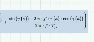

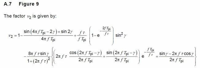

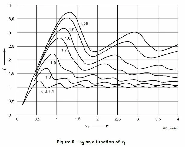

I am trying to plot something as attached below. Where v2 is a function of v1 and varies according to third variable k.v2.JPG

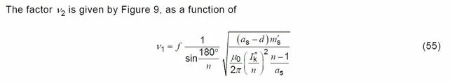

v1 is given by an equation as :
Now as for programming purpose, v1 equation is given as
But when I am trying to solve the equation using root of function k, v1 as for v2, it produce an error that end points of interval must be of opposite signs. Whereas, v2 value can not be in negative as shown in graph above. I have assigned rang from 0 to 4 as mentioned in vertical axis of graph.

The first formal analyze your calculation - the creating one user function:
Show please the article or the book with this formulas!

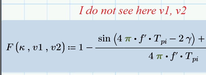

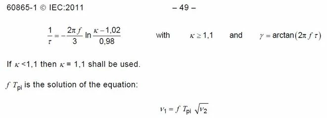

There is one more equation given for the reference. I am not sure whether I am using the correct function or not.
January 7, 2019
First these are functions of "k".  They should be carried over into function for v2 "f_v2"
you need a small correction in the last term of function "f_v2(k)" to match what you provided.
The root of the equations (where they cross v1 axis with v2 = 0) is by inspection 0,0
With what you have provided v1 does not appear in the equation for v2??
