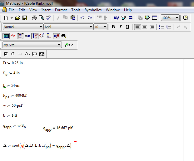

My "ROOT" operator appears to beCable+Rail01.xmcd+copy.jpg bombing out on this, I would appreciate anyone pointing out my error if you see it.

Upload the worksheet (use advanced editor - see upper right). Can't tell from the picture.
Alan
October 23, 2013
If all we see in your pic is all thats there, then the error is that you did not define a function q().
Otherwise you would have to provide more information.

You must supply either a range or an initial guess for Delta
October 23, 2013
We don't know if he has defined q() above, we don't know if he has defined a guess for Delta above, we don't know what the error message is, ...

First Let me say I am humbled by my community, thank you all for such effort. I am attaching my worksheet as suggested and I have tried a guess for variable Delta, still q bombs red. I hope the attachment helps I look forward to your replies regardless.
Thanks again,
Chris
October 23, 2013
So I was right - we really saw your full worksheet in the pic.
Are you aware that "root(q(x,y,z), x)" will try to find a solution for the equations q(x,y,z)=0 ? The values for y and z must be given/assigned to thos variables and if used in this 2-parameter form root requires you to provide a guess value for x, too. This means you would have to assign x a value, preferrably near the expected solution.
But most important you will have to tell Mathcad WHICH function q you would like to be solved. Thats what I had already written in my post above - you have to define the function q(), whatever it should be. It was not clear from the pic if you just showed a portion of your worksheet or the whole one.
So what function you are trying to get the points of zero from?
The error message is pretty clear, I think "This variable is undefined", meaning that Mathcad likes to know what q() should be.
