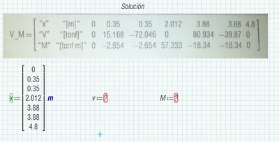

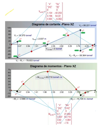

Hello dear community, I have a problem determining the roots of my function. What I want to know is the values ​​of the Y points (black color) for each graph. Please if someone can help me with this problem. My version of Mathcad Prime V.8.0
Thank you for your attention..

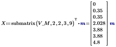

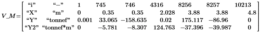

Use linterp and match functions.
PFD attached.
t.t.
Thank you for taking the time to review my dear Ttokoro, in case for a given distance you have two roots as is the case of 0.35m and 3.88m as shown in the screenshot below they have two values, one that is positive and the other negative.
