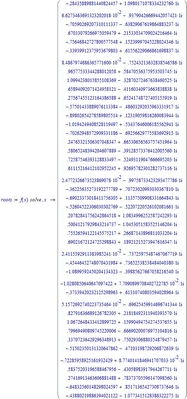

How to find all roots of this equation:

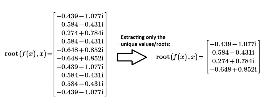

Sep 23, 2024 9:00 AM UTC
Depend on TOL. So need UniqueP function to select 4.

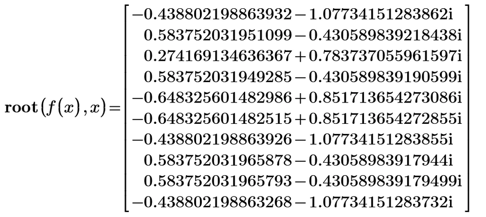

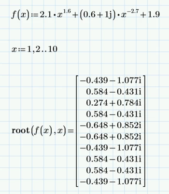

Hm...I think I found a way:
We can see that only these 4 values (roots) are repeated: -0.439-1.077i, 0.584-0.431i, 0.274+0.784i, and -0.648+0.852i.
Now I am interested in how to extract/retain only those unique 4 values?

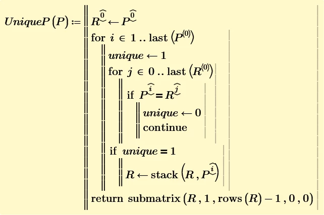

ttokoro
ttokoro21-Topaz IAnswer
t.t.

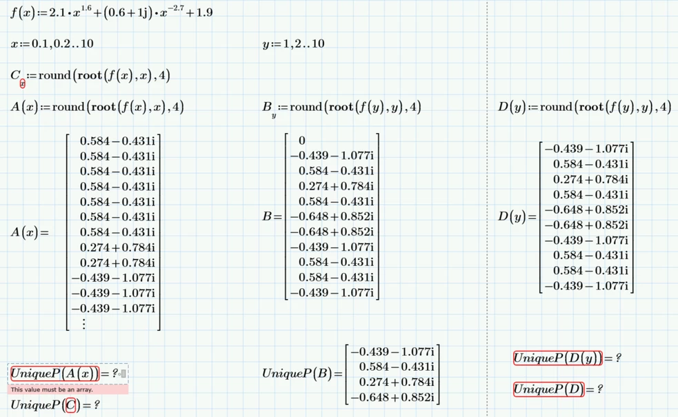

Cornel19-TanzaniteAuthor
Sep 24, 2024 7:11 AM UTC
A(x) is not an array?
I do not know how to think at the differences between the two. I see that when defining x as not integer values (0.1, 0.2, 0.3, etc), then I cannot use like Cx and also I cannot use further UniqueP function. On the other hand when defining range variable as y (1,2,3, etc, integer values), then I can use UniqueP function but only when defining with matrix index as B. Maybe someone can explain a little bit this function UniqueP, and also why I cannot use A(x) with UniqueP function.

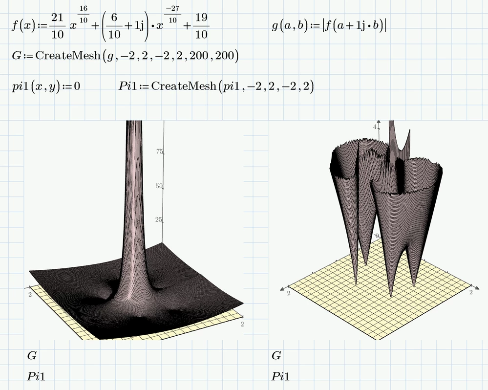

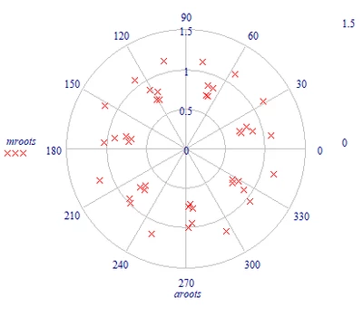

Based on the graphic, it is difficult to say whether the four spikes only 'touch' the floor plan at one point (just four solutions), or whether they penetrate it and the solution consists of four circle-like shapes. In the latter case, however, there would be an infinite number of solutions, not just 43... Can you plot the solutions in the Gauß-plane?
23-Emerald V
Sep 23, 2024 10:25 PM UTC
I guess you want to see this:
or (sorted on angle) like:
