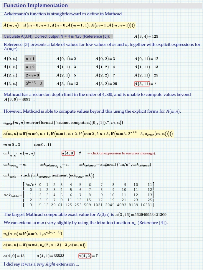

I've added the following solution to the Rosetta Code task: Ackermann Function
Here is the link to the solution on the Rosetta Code site: https://rosettacode.org/wiki/Ackermann_function#Mathcad
Stuart
