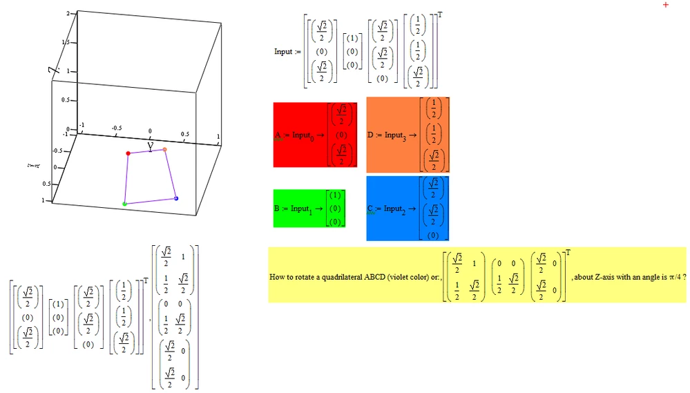

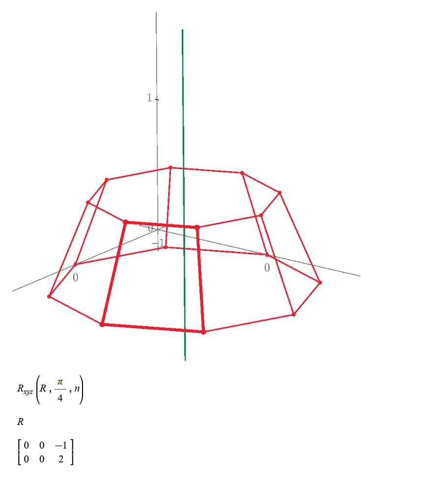

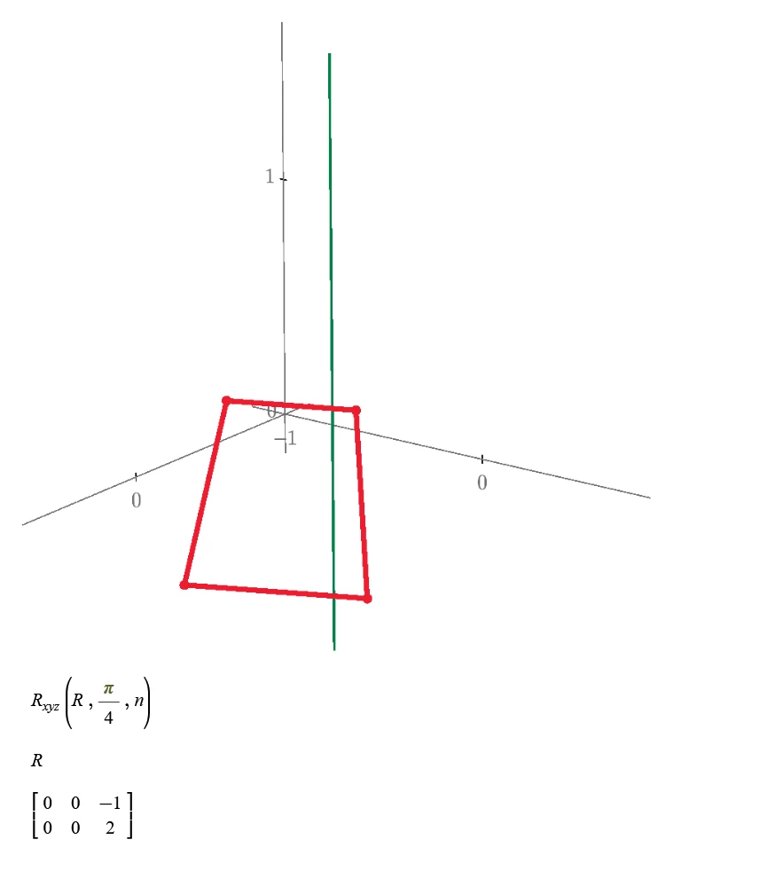

Hi Everyone,
From the following :
How to Rotate a quadrilateral and Plot its image on the Graph ?
Thanks in advance.
Best Regards.

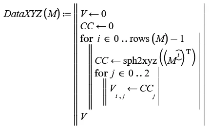

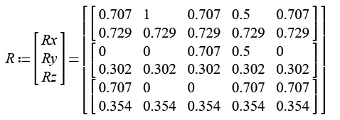

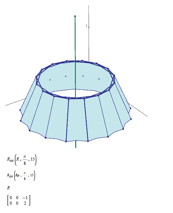

3D data format for MC15 and Prime is changed.  Prime 8 sheet attached.
t.t.
16 replies
A rotation around the z-axis can be accomplished by a multiplication with
For example
See also
https://en.wikipedia.org/wiki/Rotation_matrix#Basic_rotations
or maybe (?)
https://zh.wikipedia.org/wiki/%E6%97%8B%E8%BD%AC%E7%9F%A9%E9%98%B5#%E6%97%8B%E8%BD%AC

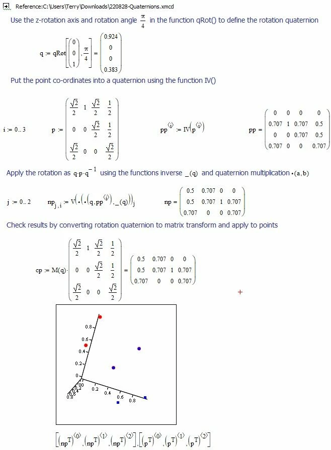

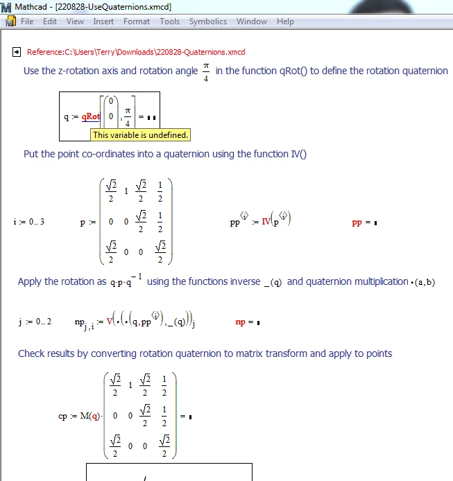

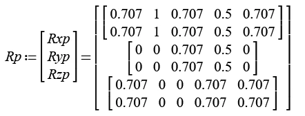

Rotations in 3D can also be carried out using Quaternions.
An excellent worksheet was posted on this forum that details Quaternions, and I include it here.
How to use the functions in the worksheet to do the rotation of the quadrilateral is also included.
I also have Prime 8 versions of the sheets if anyone wants them.
Cheers
Terry

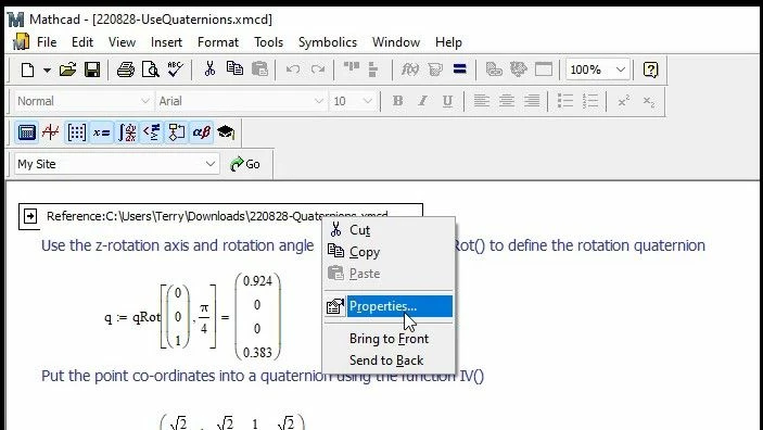

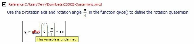

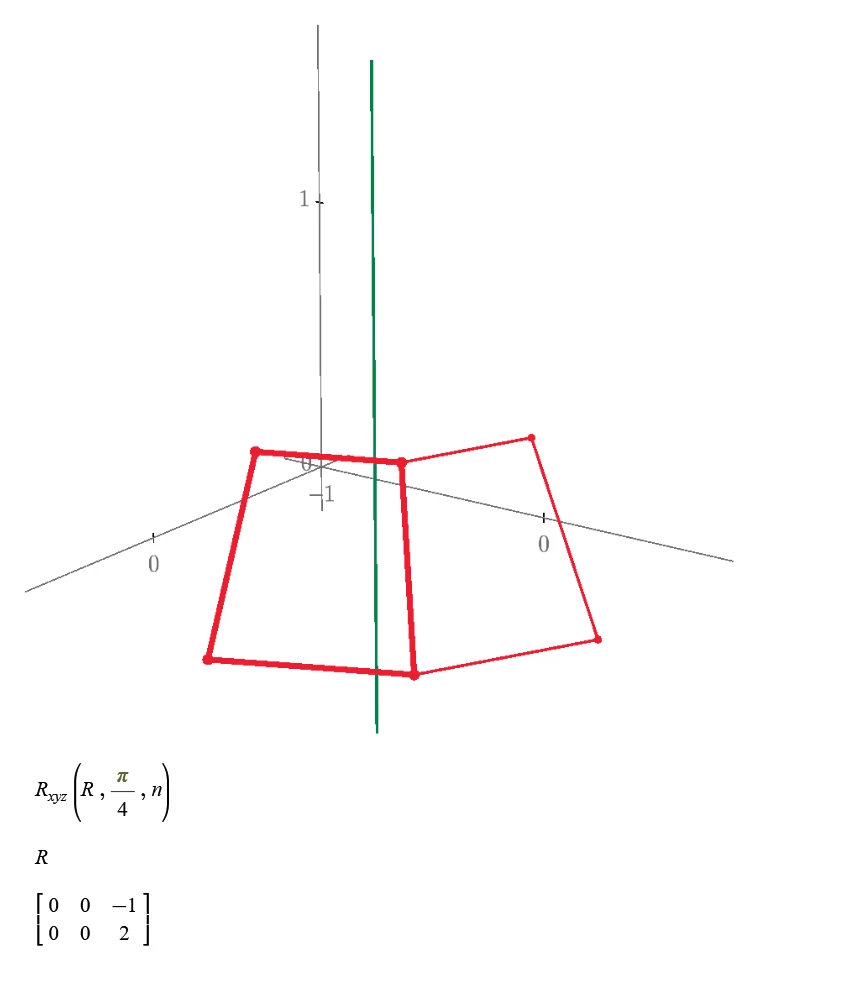

I greately appreciate your time and help with your *.xmcd attacted. I don't the reason for as the following:
"This variable is undefined" was shown.
Thanks again.
Loi.

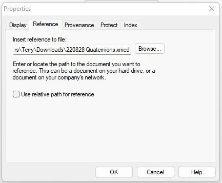

terryhendicott
File location for the referenced sheet at the top of the page must be adjusted to suit your system where the file is located.
Right click on the little arrow and you get this pop up menu and select properties
This pops up a tabbed dialog box go to Reference Tab
Here you can browse button to the location of the file "220828-Quaternions.xmcd" on your system and OK.
Cheers
Terry
